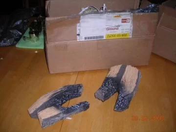

I have a log set from Travis Ind. that was shipped to me and arrived in two pieces so it was free. I drilled a hole in each broken end, stuck a nail in there and basically glued it back together with 1200 degree masonry cement. It is holding up good so far. It does get covered with ash as expected, but I take all the stuff that needs to be brushed off outside to clean up. I do like the look much better. I have used it off and on and the only bad thing I have experienced is that the glass really does get dirty quicker. If you have to clean the glass everyday anyway, as I do, it really doesn't matter.
