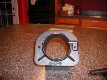

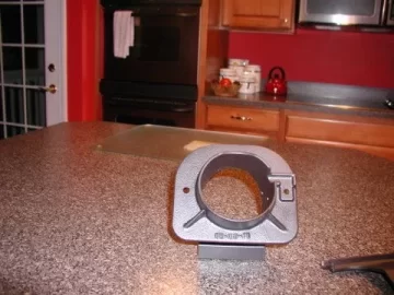

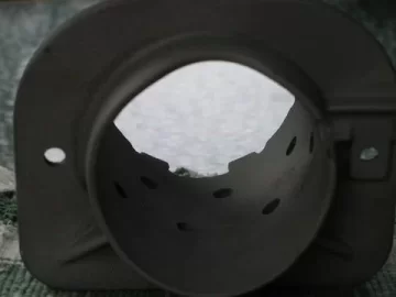

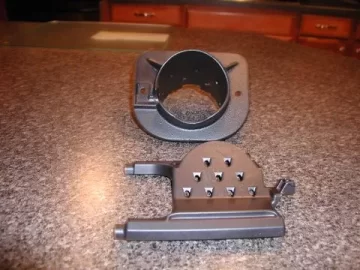

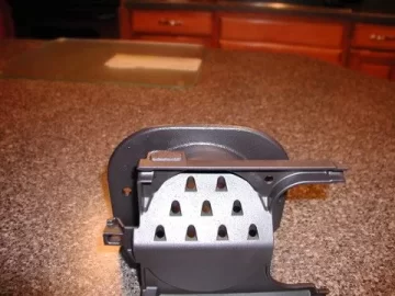

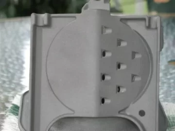

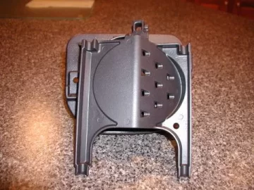

i tried a wire brush in a cordless drill to clean the burn pot to no avail.
i payed $20 to have the two pieces sand blasted before i brought them to the machine shop.
the machine shop had to re-sandblast them with a different sand grit.
the machine shop ( they specialize in high performance skidoos ) charged me $72 for the sand blast and ceramic coating.
i live outside a city of about 60,000 people, so this should be available just about everywhere.
the reason i had the pot coated was to see if it would be easier to clean, hopefully a rag should do it.
i will post a follow up on how this worked out after i fire it up in a few months.
