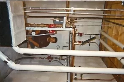

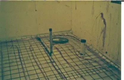

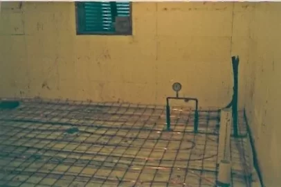

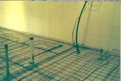

Absolutely yes you can. Vapor barrier first followed by pink or blue board thickness is up to you I like 1" in this case. Next wire mesh and nail it down with concrete nails allowing a little wiggle room. Next tie your tubing to the wire mesh and cover with concrete. Don't forget perimeter insulation. Cap the tubing off and pump up to at least 50 psi while pouring concrete. Big draw backs in doing this is, can you afford the extra height with the insulation and concrete in your basement. I done it in mine and it works like a charm. I used bubble foil bubble (cringing) and this was designed by an engineer for my house. Yes I poured a floor over a floor in a new construction house. Been for years and working like a charm.
