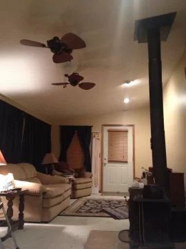

Thanks for the posts so far everyone. I am def going to do some experimenting. The fan is about 3 feet away from the front of the stove. I had an old standard ceiling fan that I always ran in updraft mode so to not get a draft in the room. This fall I installed a new fan that has 2 motors with 3 short fat blades off each one. The new fan design makes each motor/blade offset to each side of the stove... Which made me start to question which way is best to run them. I will upload a pic of the setup later if I can. I'm out of town in Erie PA right now so it might not be until Sunday night.
Here is the setup. It's too warm tonight to get a good fire going so I will have to do some experimenting later in the week. I'll let you all know what I find.

Definitely blowing towards the ceiling. The purpose of the ceiling fan is to stir up the air and reduce thermal stratification, you know, that hot at the ceiling and cold at the floor feeling. The intent is not blow air at anything or anybody, these drafts might feel nice in the summer or when you are trying to stay cool but not in the winter when heating with a hot box on the floor.

That's what I was thinking Highbeam. I'm going to experiment still and see if I find any difference with the new fan setup.

That's what I've always known as well but with the new fan configuration it has me questioning. I still think up will be best but I'm still going to experiment just to make sure. Might even pull out some incents and test a few spots like I read someone else did recently.
