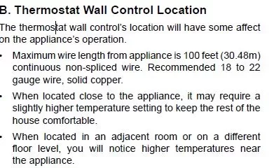

I must be looking at the wrong CB manual. The install manual I'm looking at says 100 feet for the wall location - which being wired makes more sense to me. With a house that is 1,000 sq/ft, you certainly don't need 100', but it also gives you options. If you are looking to heat your whole house, I would try to place it in a room about the midpoint of the house, and around a door. Obviously the room that the stove is in will be warmer than the set point, but the rooms furthest away will be cooler. The more stable the room temp, the less cycling the stove will go thru and I believe the happier you will be. In the floor layout attached, the red dot is where I have my thermostat, and it works perfectly for my needs there.
View attachment 294875 View attachment 294876
