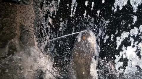

I have a 10+ year old Central Boiler, CL 4436 That has developed a pinhole leak in the fire box side wall. I assume it is from corrosion.
I have not used any chemicals in it for over 8 years. It is connected directly to my FHW oil system in the house. The CB is elevated enough that my system in the house runs at around 12psi.
Can I assume that I am corroding the system in the house as well? ( I installed a new Buderus cold start boiler in the house about 5 years ago) After I weld the leak in the CB, would testing and adding chemicals be advised? Would I be better off adding a heat exchanger between the two systems? Any advice would be helpful.
Thanks,
David
