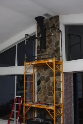

Mine still looks like this:
I really need to get up there and seal it off. I used a lot of barn tin inside, so I think I will insulate the opening, then build a barn tin chase around the flue pipe.

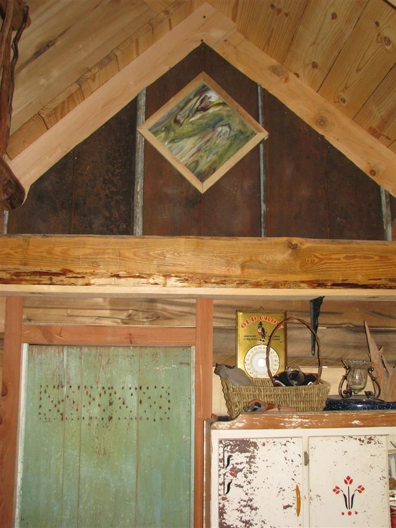

Barn tin:
It looks and feels just like fiberglass. It resembles roxul in no way. We have lots of both, rarely use the JUSI.This is a grey area. If you want to be squeaky right, get the mfg. insulation and keep the receipt. That way you are documented with an approved insulation. It's probably just roxul, but it is best not to have any area of dispute with the insurance co or inspecting authority.
