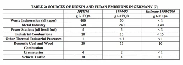

Well, I think wildfires are the biggest of those projects... a quick search shows a huge decrease of man-made emissions to levels about the same as wildfires. Those EPA man-made estimates are ALL sources combined, of which wood stoves must be a small fraction, and cat stoves only a tiny fraction of a fraction.
http://www.dioxinfacts.org/images/fires3.gif
This is Germany, and maybe US percentage distribution would be different but burning wood for residential heat, while significant, doesn't appear to be that big compared to industrial sources. Maybe we don't have as many metal industries here a Germany does.
Then you would have to subtract the pollution that would have been created by production, transportation etc, if the wood burner had instead been heating the home with oil, gas or electric. To be fair, you would also have to factor in pollution created by getting the firewood cut and ready to burn. Catalytic stoves and health concerns
