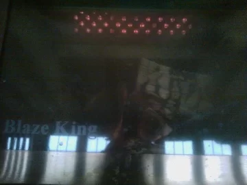

Last night I tried this.... I dont have a thermometer so no temps to go by
Cold start - Bypass fully open and full air - loaded with 5 med size splits of cherry, 1/4 super cedar and some splitter scraps
After about 8min with a good set of flames I moved the bypass to 1/2 open, still full air
Another 5 min (fire really going strong) I shut the bypass completely, still full air
5 more min - Cat is really glowing, shut air down to 1/2 way
fan kicked on about 2 min later - approx 20 min from cold start
5 more min - air down to 25% open - left it there (fell a sleep in my chair)
I will try this approach again, it appears that adding in the bypass 1/2 way step helped speed up the process of bringing the temps up quicker making the overall burn more efficient.
