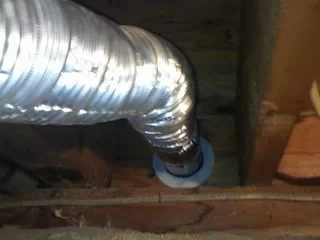

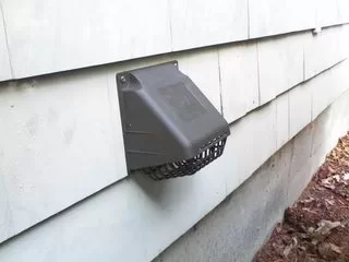

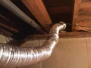

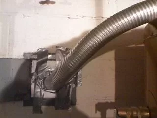

Hi Dave.
Used approx. 17 ft of pipe from the stove to the outdoors. The first
6 ft is 2" diameter, then increased to 3" aluminum for the rest of the run.
Sorry, should have read the post you linked me to more carefully! If you working OK at 17, i might be able to pull this off. Any chance you could post a pick of what it looks like in your basement? Thanks so much, you've been a big help. DAVE
Not much to get from the pics that I didn't already
explain but here's what I have for pics. It's pretty
easy and I did it myself except for cutting the hole which
I had the brother do.
The most time consuming was finding the parts. The job
itself was cake.
