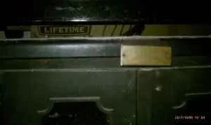

Do any of you recognize this insert? Is it worth picking up? I mean, for $200 that's pretty cheap. The guy selling it doesn't seem to know much about it (kinda like me when I sold an old wood stove I also was given a few years ago).
Looks like another old Buck Stove or something like it. If the part where it goes into the chimney is just a wide oblong slot, that means it would be difficult for you to hook it up to a liner for a safer installation.
Thanks. I'll try to get some more info on it. With the new EPA (I shudder to say that name...) inserts, should I bother with an older insert, are they going to burn a ton more wood, smoke a lot, etc? I know jack about these things...
I'd call it scrap metal and walk away from it. If you're looking to get into heating with wood, you'll be doing yourself a huge favor if you spend a good deal of time learning all you can about the whole process before starting to lay out your hard earned cash on hardware you know nothing about. Rick
Seems like some who had a particular old stove in their past will want to give it the TLC to make it operate at it's best and safest, regardless of the trouble it can take. There are lots of folks on here running old Bucks, Fishers, etc. But since this one is not sentimental to you, you can surely find an easier stove to rehab, or even a new one, at a decent price. THe EPA ones even allow you to see the fire through the glass for more than the first burn! Good luck!
