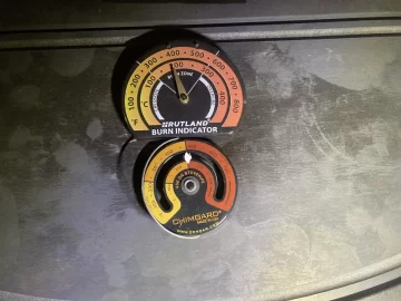

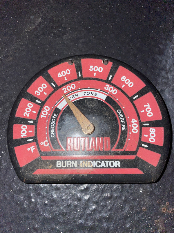

I have one of these magnetic stovetop thermometers and it reads 100 degrees below the actual temp. Is there a way to adjust them? I see no adjustment so thinking only way might be to bend them? I tried once and didn't seem like it would work.
I have a Rutland thermometer that read about 100 degrees too cold when I got it. I bent the arm a little until it matched my infrared thermometer. Now it tracks it pretty decent.
