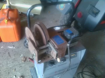

I found this old power in/out AC winch in the barn. I've been thinking that I might be better off with the winch on a crane than a lift. The lift seems like it would get in the way?

I was thinking of a small shop lift that has a stand and an electric winch.This way I do not have to weld it to my machine and if I want to go either vert or horz it will not get in the way.I was also thinking it can fold up for easy storage.It really does not have to be that strong,on the really heavy ones i think it would be easier to to go horz anyway
Never thought about the truck crane lift or a winch mounted above. If I get the new shed in this spring/summer I will have dedicated space for the splitter and splitting so the next logical step would be one of those.
