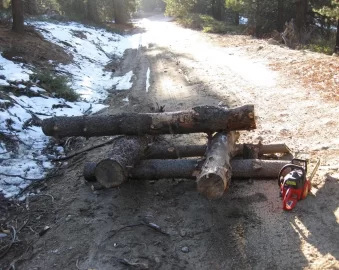

Well went up today and got me some wood. I cut some rounds and measured from the center across the grain (10%) and towards the edge across the grain(11%). I then split the round and measured center across the grain(13%) and at the edge across the grain(18%). The results were pretty close +/- 7%. Enough for me to decide if I wanted to continue cutting the log and bring the wood home or leave it and search for more "ready to burn" wood. Here are the pics of the results.

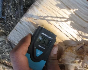

OK here is are the pics with the measure taken from the center of the split with the grain and across the grain.
  • [Hearth.com] Can moisture meter be used on end grain of a fresh cut round with any accuracy?
Well 2% doesn't seem too bad. Thanks for the comparison!

I can't say I agree with that false reading with the grain/across the grain stuff. I have tried all the different ways trying to get different readings and as long as you push the probes in deep enough it seems to give the same, or very similar, readings. The biggest differences I find are in reading the outside surface of the wood as opposed to freshly splitting or cutting open the wood and taking an inside reading. You can't go by an outside reading, you gota cut, or split, the wood open to get a true reading.
I agree with measuring the inside. Usually the outside of a log would give you a dryer reading than the inside of a split. In my case however as you can see in the pic, they already had some snowfall and the logs would give a higher reading on the outside than the inside. This is why I wanted to know about cutting a log and getting a quick reading to see if once split it would be somewhat close to the cut reading. I found that it was close enough for me to carry the damn log down the hill to cut. I sure would have been upset to have carried a bunch of logs down the hill only to find out that they were over 35% and although good wood not good for burning this year. I did split some of the rounds and found that about an inch of the outer edge quite a bit higher moisture % than the center. Absorbed moisture from being on the ground. I figure that when I get to these logs in a few months that that moisture will have evaporated since they will have been split up off the ground and had some time to dry. It was pretty nice up there, and since this is a 'gear' section I will through in part of my foraging gear. My little hunting truck that my wife hates. haha. Whoops too big see next posting for truck pic

Truck pic
By looking at those logs, with the bark falling off, I'm sure they would be well "seasoned", just a mater of drying out the surface moisture,,, same as the downed trees I was dealing with.
Does look nice up there, must have been around sunset.
