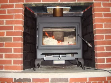

Over the holidays many a friend, foe, canine, and feline have partaken in my groovy Englander 13 surrounded by 1957 red brick. Some suggested I go with a light-colored stone covering rather than paint over the red brick.
Can I add stone veneers and not burn the house down? The stove is very close to the brick. Do these stone veneers have similar fire/heat ratings?
Please let me know your thoughts on this. Thank you.

You can cover the brick with stone veneer. It would have no effect on the thermal qualities of the brick.

Yes. You want to take care with your choice of mortar when it is that close so that it does not crack in the heat. There are thinset mortars with additives that will work well. Clean the brick with TSP and you may want to brush a layer of mortar bonding agent to the brick. You should not need to use durock or metal lathe as the brick looks like it has a rough surface. I put a 1" thick real stone veneer on my back wall and I really like the look of it.
You do need to check your clearances to combustibles and make sure you are still at code.

Thank you, Gents. Probably a project for late Spring, but want to get ready. I see some photos on this site and like the look of stone rather than my red brick. I just wanted to make sure the veneer can literally take the heat (so close to the stove). Appreciate the advice on the mortar mix.

I forgot to mention that you want to put a scratch coat of mortar on the bricks first and let it dry a day before putting the final coat with the stone veneer on it. That creates a smooth surface to apply the stone veneer. You could try one coat but I'm not sure how much experience you have with stone. Applying stone veneer is very easy once you get the trick of how hydraulic suction works. Smoosh the stone against the wall, hold it for a moment, then let go. It just hangs were you put it.
It might be best to search craigslist for someone who has some left over from a project. I found 3 lots that way that were very cheap. Have a good look at the stone. There are lots of fake ones made of cement and lots of people think they are real. Genuine stone veneer is very pricey but much more beautiful.

@kenny: Thank you for noticing the block-off plate. Being a newbie, I wanted something I could disassemble quickly to check as often as I needed during my first few seasons of burning wood. The block-off plate utilizes two wing nuts to hold it all together- unscrew those and the block-off plate's 3 sections come apart in about 3 minutes.
Instead of mounting the block-off plate's sheet metal directly to the firebox walls, I used Tapcon masonry screws to secure 1.5 inch wide sheet metal connectors all the way around the top of the firebox, then just slid the block-off plate sheets into them.

My stone veneer is made out of portland cement...no worries about the heat.
