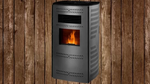

So my stove (Englander 25IP Imperial, pic below) burns great on 2 with a nice white/yellow torch like flame.....
but on 1 it's just lazy (like me in my 20's) and the pellets are building up.... any thoughts???
Here's what I have done.....
-cleaned
*flu/exhaust pipe brushed and leaf blower tricked it,
*burnpot, ashpan, burn chamber
*heat exchanger (bang with a hammer and removed cleaning port covers, vacuumed)
*even removed the combustion/exhaust motor and cleaned from there to the heat exchanger as best I could....
-checked for leaks on door, ashpan, hopper, exhaust/combustion motor assembly.....
-tried 3 different pellet types
After I cleaned everything I thought it must be the exhaust/combustion motor....... 90% of the time run it on 1 so I turned it to 2 and it runs great...... it used to run great on 1 and can't imagine why it would have changed
