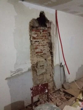

Hi guys
I'm new on this forum. I need an advice from the experts who are familiar with building a Rumford fireplace. I'm using the plans provided by rumford.com website. But I cannot use their components so I need to cast them by myself. Since my chimney is already built I need to make a connection from the smoke chamber to the chimney and there will be a little offset by doing that. I'm wondering, what is the code for the slope that I have to make? Currently I'm at 30 degrees angle. How should I make the connection from the smoke chamber to the chimney? Should I use a flex liner flue or what? Other thing, should I make the smoke chamber by corbeling the bricks and then parging the inner surface of the chamber with refractory mortar or casting the chamber from some other material? Here is a picture for a better illustration.

Hi, Poindexter. Thank you for tour help. I appreciate it. I've already got the firebricks and the stove is not an option in the interior design, like you said I'm looking more ambient not just BTUs. I contacted Jim from rumford.com, he wrote me a few mails but hasn't wrote me yet for hiving me advice on the chimney offsets and connections from the smoke chamber to the chimney. That's why I came here because I need to start the building process as soon as possible. Did you make your previous rumford by yourself? If yes, how did you cast the throat? Using a ferrocement techniques? I know the book but I'm running outof time to get it since I'm not from us. I'm in Europe and shipping could take a few weeks because is paperback. :(

What i remember about the rumford i have operated is it has really really good draft. I ass/u\me your chimney opening is about 5 feet, 60 inches, 1.5 meters off the floor. My swag ( scientific wild a** guess) is, without further demolition, to get a good running rumford in there your max opening is going to be 25-30 inches vertical, tops, and maybe 20 inches wide, about .5 x .5 meters.

I'n building it by myself but since I don't have the premade rumford components I'm doing everything from scratch. But did sir Rumford had a premade components back then? Lol yes the chimbey is off the ground about 200cm probably, that's correct. The size of the firebox will be 76.2 cm (30") wide by 76.2 cm (30") tall. First I wanted 91cm by 91cm i.e. (36" by 36") but I'm limited due to my pre-existing building conditions (such as chimney, offsets etc, brick removal from the wall and increasing a big angle for the flue connection) Do you think I should use a flex liner to make the connection up to the chimney or you can't give me advice on that?

I can't give you informed reasonable advice on that.
