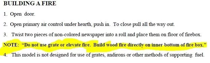

My stove's manual warns not to install a grate. There is a very real danger of overfiring a stove that was not designed to have a grate. There is even a risk of overfiring by N/S loading without a grate.tcassavaugh said:I've never seen instructions, in a stove, not to build on the grate.
tcassavaugh said:if a grate is IN the stove as an intragal part of the stove wasn't it designed to have one in it? Mabe i'm reading the post wrong.

BeGreen said:A good place to start would be the manual!
Spencer H. said:BeGreen said:A good place to start would be the manual!
Interesting. The manual for the 27000 stove found on this page ((broken link removed to http://www.buckstove.com/stovemanuals.html))
says that firedogs are supplied with the stove, which elevates the fire as does a grate. What manual is that picture from?
