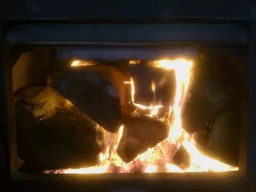

Wife got so cold I had to get it going.

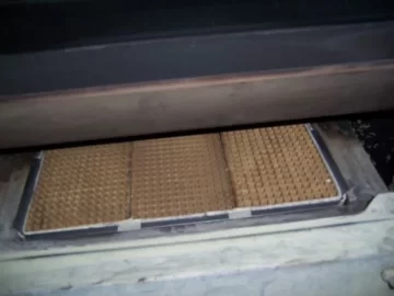

So I used the new one, figure $330, should put it to use.

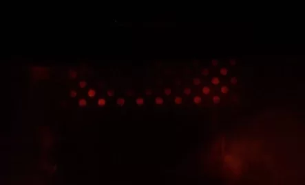

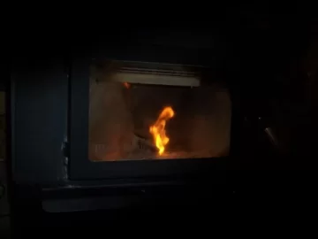

WOW, what a difference, I could turn the stove stat to 3 & had flames, cat temp to 3/4.
Haven't been able to do that since i burned the spruce on medium setting.

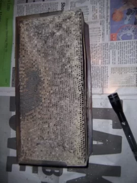

I vacuumed out the old one & will keep as a spare, since it may get warm again & I'll try to burn on a lower setting.

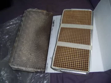

Old one was in about 8 months of 24/7 burning, first time I took it out. (New Last December) Fire store guy said it was still good,

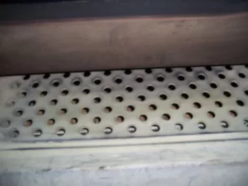

but I liked the larger holes in the new ceramic one so I bought it.
I can take it out for cleaning & have the old one if ever needed.

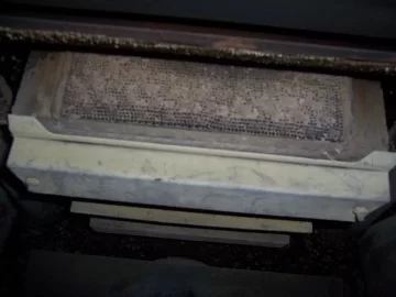

He said "IT JUST NEEDS CLEANED", ;-P so I guess I'll put that one the "PM list" & clean it better (new one too) Got 2 spare gaskets while I was there to, for future cleanings.

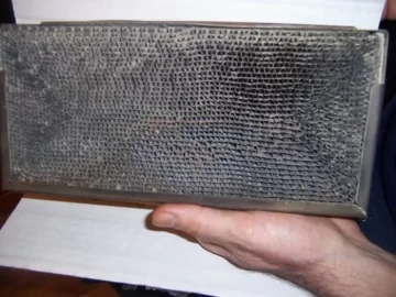

Tried big hot fire for 3 days & the old one but would not burn itself clean, it looked like it was plugged with gray ash, front & back, just 30% of it was open. (my fault)
I would have been fine for years if I had too but the fine smaller hole plug easier & today while I let the fire go out & clean it, my Wife was getting cold, (house was down to 70
