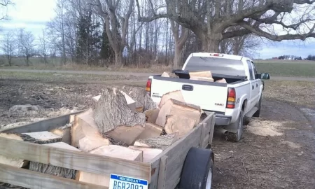

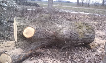

Find out what size stihl you can get your hands on. If it has a 16" bar your ok, just make sure your using a full chisel chain, SHARP. When you noodle cut with the grain , in otherwords , lay the wood on the side so your cutting the bark first and you'll go thru fast making large "noodles. With a 16" bar you'll need to cut on the backside as well. I use a 20" bar and I can noodle 16-17 inch plus no problem. Just finished noodling this big notty bur oak today!
