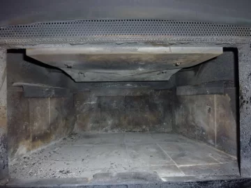

Some pictures...again they will be grainy because they were taken on a mobile device.
1) The initial burn.
2) The burn tubes kicking in a bit...
![Buck Stove Model 94NC Buck Stove Model 94NC](https://www.hearth.com/talk/data/attachments/158/158341-38d4d6c948d5c163f7842179a3815941.jpg)
