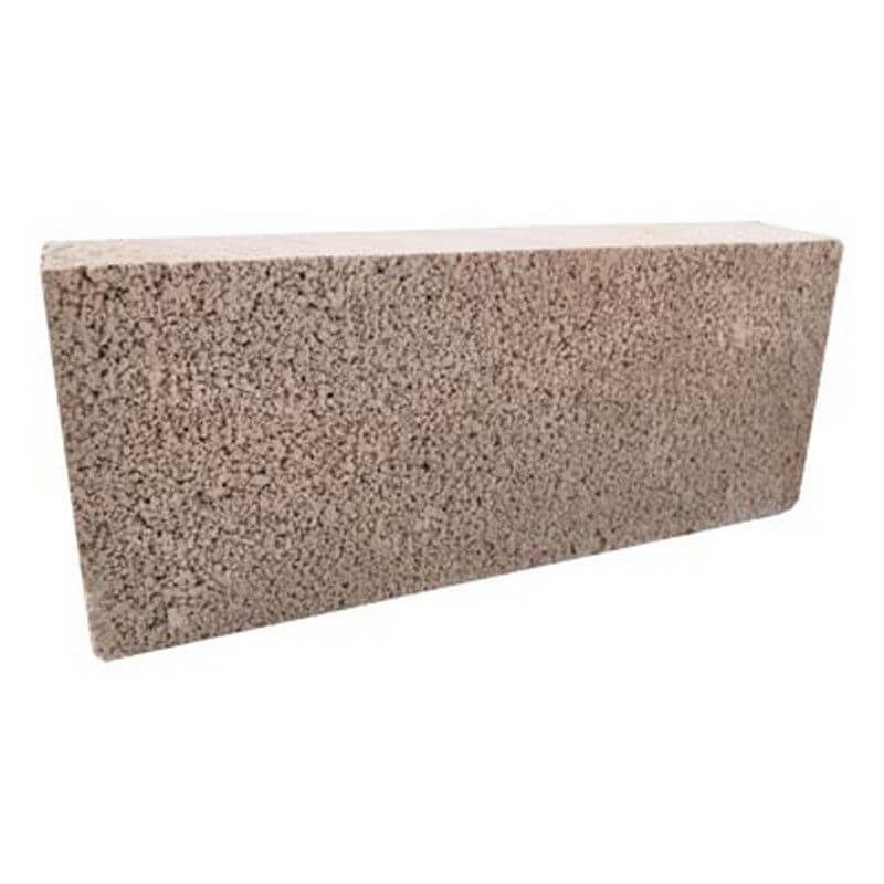

Just finally found out that the bricks I bought are not US Stove Co.; they're SBI. Not sure if this makes a difference -- sold as PE replacements so presumably I can still use in combination with original PE bricks on the floor?
As long as they are pumice bricks they are fine.
Not sure how to find that out. They feel like the originals, but they're grey, not pinkish.
I tried to find the info online but most places just say "refractory" and the couple that did specify seemed to be saying they were made of ceramic, with no picture so maybe that was a different product? I could never be sure the products I was looking up were what I bought.
So I called the store where I bought the 12 (again) and he told me they're made of stone but couldn't say whether the stone is pumice or not. He insisted that there would be no problem in using them in combination with the old ones (well, he IS selling them in place of real PE replacement parts).
I went on the SBI International site (they seem to be here in Québec) and they only describe the stoves they sell -- no mention of bricks whatsoever.
I found this site that is selling what appears to be the same bricks I bought, but at a much higher price -- I paid $3.45 a brick, and that was at a retailer with an actual store and associated overhead -- can't be the same bricks, surely!
I'm just going to put my baffle back in and pour an inch of ash in so I can use my stove -- supposed to be cold Sunday night. I am very annoyed at how hard it is to get essential information.
Actually, those are NOT the same bricks -- pinker and narrower. Mine are just over
4 1/4" wide, a little short of 9" long, and
1 1/4" thick. They're the colour and texture of cinder block.
[Hearth.com] bricking over ash dump pe
I think SBI also uses pumice bricks. If they feel about the same weight as the originals then they are. They look like pumice.
