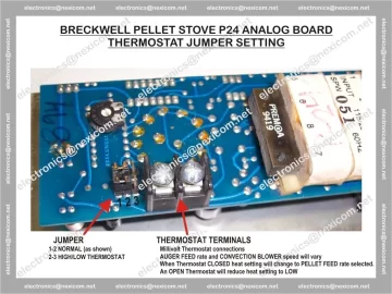

I have an older Breckwell insert 1994 or 95. I bought it used. I want to hook it up to a simple millivolt thermostat but don't know where the jumpers should be set on the back of the board. If anyone can help I can e-mail photos of the board. ( not sure how to attach them here )
Here this should help you.
Let me know how you make out.
Make sure you unplug the stove before moving jumper and while wiring THERMOSTAT to connection on terminal switch.
