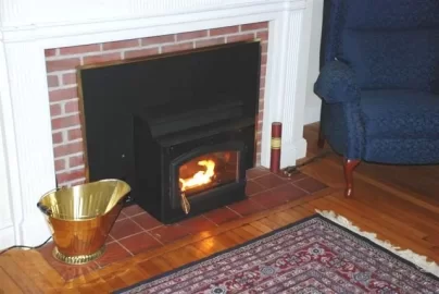

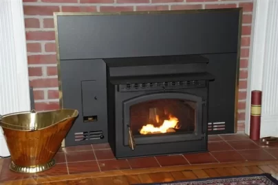

Just got my P23I installed this weekend. Seems excellent so far.
My question is regarding combustion air. From the picture you can see the flame
swirled toward the front. Watching the flame it seems that there is air coming from
somewhere (the pellet feed shoot?) which blows the flame forward. Is this normal or
should the flame shoot up straight?

Dear God man, open the damper and give the fire some air. From what I see in the pic you have the damper closed all the way. If you are running at level 1 have it almost closed but fire needs air.
Where is your dealer? Have you spoke to him/her (PC).
Eric
We bought this exact stove last year.... Love it.. We never have had a issue, We use a programable thermostat to control it 100% of the time. Just fill it once a day and it turns on/off by itself. (We use a 3 degree swing on the thermostat, I found it to be the best)
I've played around with the air setting using a high temperature thermocouple to monitor the fire over time. So far we found that - Yes your picture look's like it needs more air. I found a sweet spot that I marked on my stove -you want the flame to burn kinda straight up, More air = more heat. But you don't want to much air to the point where your blowing the pellets out of the pot. Our stove has great air flow, so you don't need to open it more than 1/2 inch.
If your using the Hi/Low option - You need to shut the air down pretty low. If I'm burning poor pellets,(Home depots) the flame will blow itself out.
Best thing to do is have fun and find the setting you like.
FYI - Best pellets I have found are at Tractor supply/Lowes made by Somerset. Worst are Home Depots Fireside ultra and stove chow (Don't waste your money on these).

I wanted to make sure I got the damper setting correct before I let it cycle automatically. I've been switching between level 1 and 3 to get the best compromise between good flame on setting 3 and not going out on the low feed 1 setting.
I've got it running much better than in my pics which were taken on the first day I had the stove. Hopfully I'll hook up the thermostat when I get some time after Thanksgiving dinner on Thursday.
