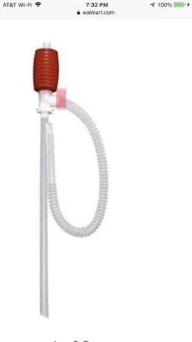

[Hearth.com] Breckwell Big E SP1000 I used one of these for years to get back in there. Cut off the corrugated side and vinly taped to my shop vac
