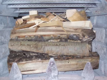

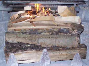

Forgot to mention that you could also try a top down fire (if you have not already). That method works the best in my BIS. Here is some pics of mine.

Islander, try the upside down fire to start your Nova. It works with amazing results. The above pics are the way I always start mine right from cold. Set it up as shown in the pic and light the small twigs, close the doors, and it will look after itself for at least 4 beers.

Your top down firestarting technique works great!! I now use it every time, and as you say its light it anf forget it for an hour.
Thanks for the tip!!
