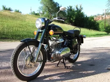

At least some variants of the 6LD series have a speed controllable governor, some with a knob and a set screw, some designed to be cable controlled. At any rate the governors on these engines are very simple and it is a trivial matter to fabricate an adjustable unit if it doesn't have what you want already. I installed a very similar Yanmar diesel engine into a Royal Enfield motorcycle and had to fabricate a better control assy for it, the original was not only quite crude but it also fouled on the transmission. Very simple to build a better one. Keep in mind however, that all of these engines have fixed start of injection timing ( not controlled by rpm) so it is difficult to get them to run perfectly over a large range of RPM's. That said I was able to get the Yanmar set to where it is usable on a motorcycle.
WOW! That's really cool. Nice to have another soot head on the board.
Also, NoPaint, good luck with your engine.

This being a used engine shouldn't have air in the lines. I would just check the fluids and give it a try. Cool enfield project.
