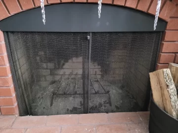

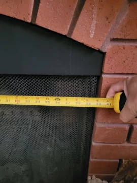

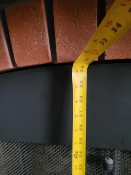

@john26Thank so much for the details. My fireplace has decent size opening so hopefully it will be easier to connect the liner. I saw one from Chimney liner depot. Not sure if it is any good. 🤷 Unless someone has a better recommendation.
How many hours did it take you to complete it? I just want to make sure to budget enough time to do it.
