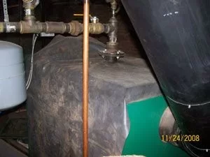

I bought an EKO standard used, It was one of the first EKO's that Zenon ever sold and I've used it 2 winters.. I have cracked U
shape blocks, and I've replaced door gaskets..I did have a couple fixes along the way, but they were not all the EKO's fault..As a
preventitive measure next year I will replace the nozzles.. Thats it, I am very pleased with how this EKO standard is holding up..I
posted some pics for the heck of it, these were the things I did work on.. one pic shows my EKO EPDM cover, one shows the new
flange I had made cause it only came with 1 flange, the other pic shows that I had to adjust the secondary inlet adjustments..
NO expensive repairs to date..
