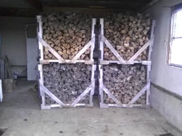

My garage is quickly becoming not a garage. Cars are taking a backseat to toys and such.
I was curious the thoughts on putting the boiler and storage in the "garage" It's pretty easy for me to move out all the gas engine stuff... and gas tanks and whatnot for flammables. The only vehicles that could go in there are diesels.
From what I understand... to be legal I'd have to have the boiler walled off with fire rated sheetrock. The door to the boiler "room" would have to go into a room other than the garage. (I can accomplish this by going from the boiler room to the utility room, which is walled off from the garage.
If I were to follow this code... I'd have a removable 5' section of wall. Then I could plunk my pallets full of wood next to the boiler.
Not sure if being to code is worth it. I think with common sense I can be just as safe without the walled off part.
Thoughts?

The pallets are 48x42's. The way the pallets are attached on the ends, gives me the full 48. My wood is 20 inches long. So I have two rows on a pallet. When we stack off of the splitter, we round the wood up. About as close to 1/2 a cord as you can get, with those pallets. When stacking in garage, just before winter sets in, I skim the wood off of the top. A couple times during the winter, I have to lift the top pallets and put them on the ground as needed.
Thanks, that will be my first project this spring. I can place in the boiler room with the forks on the tractor and never touch the wood again between the splitter and the firebox.

I am doing near the same thing as those good looking pallets. Mine I put a brace across the center on top, and one acoss at the mid level. I did the math and thought it was closer to a third of a cord. I just put up my 20th of them today. 4 are all red oak.. but the rest will be ready for next year. I just need some 4' forks for my tractor. The 3 footers put too much pressure on the middle of the pallet when lifting. I think I can get 4 pallets in along one side of my garage, and still have the cars in there. I figure a hand pallet jack with be able to shuffle them around in the garage and get the one I'm using right up within 3' of the stove and still not be in the way of anything else. Humidity runs in the high 30s low 40s in the house.. and I was keeping the garage around 60 with the oil boiler. I plan to heat the garage and basement hotter when using wood. I figure it will really dry out the wood that last few weeks in the garage.

I also have some pallets that have piece of 2x4 across the top. I stack 3 rows of wood on each pallet. The pallet is 48 inches wide, but i out 3 rows of 20 inch wood. Overhangs a bit, but manageable.
That third row of wood I think would put it over the top for the lifting ability of the tractor. Maybe not. I know that it doesn't work now with the short forks. That end frow furthest from me can get leaned outboard and popped off if I overhang much off the pallet. I bet if it was dry it wouldn't be an issue. I'm stacking it green right from the splitter, so I think using a few more pallets, but only handing the wood that one time is more important.
I just need more nice level dry gravel to put them on. The wonderful place I'm using now is supposet to have a "toy barn" on it. Soon.

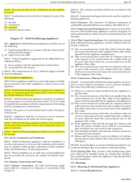

I live in Northern Michigan and was required to have a seperate entrance into my boiler room that is on the rear wall of the garage. (a lean to off the rear wall on the exterior that I turned into an insulated boiler room).
The local mechanical inspector (Rob Hilton @ Charlevoix County) told me that fossil fuel burning devices are OK to put in a garage as long as they are rasied to a height where the flames/burner is 18" of the garage floor (this is so that the gas fumes from a gas tank leak wll sink to the garage floor because they are heavier than air, thus reducing the risk of explosion).
However, solid fuel burning devices (even though the SAME flame is elevated above the floor the SAME 18" are not allowed in a garage. If they are in a garage than they must be in their own "boiler room" which cannot be accessed from a door within the garage itself (a seperate entrance is the only allowable entrance to the boiler room). I was told this is because a solid fuel burning device does not have the ability to shut off the combustion process quickly like that of a propane or oil burner.
They could be placed in a breezeway that is between a garage and a house or in the house itself but are absolutely not allowed in a garage in Michigan. I'm assuming this code is a nationwide code but I don't have the acutal documentation to back up this assumption.

That's the exact same code here in my neck of the woods in Virginia, Brian. Boiler room walled off from the garage, door directly to the outside. They asked for a UL listing on the boiler and to follow the manufacturers installation instructions. It's the Internatonal Building Code that's used here. Don't go againt the codes or not get inspected, or your insurance company has an easy out if you have a fire. To many flammables and fumes in a garage for it to safely house a boiler. That recent post with pictures of a burning garage should serve as ample warning. It was a wake-up call for me.

Michigan Residential code - Section M1905 - installed accordance with NFPA 211-2006 I don't have a copy of it, but memory says no solid burning appliances in attached garages and I don't think there is verbiage about a separate entrance. Here they allow a separate room with a spring loaded door. [same as a gas appliance setting on the floor]
from 2003.
please disregard the top highlighted text and refer to the highlighted ones lower down the page.

Bigburner, I think the ticket is, if you wall off a room in your garage with no doors or openings from it to the garage , it is no longer in, or part of, the garage. That's the interpretation hereabouts. Which codebook is that attachment from Scott?
