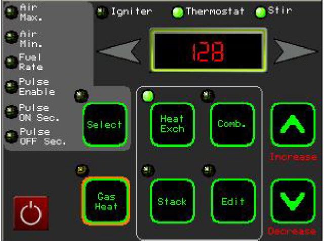

Just click "on" to start.

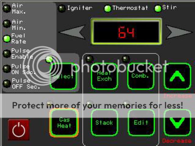

Green light on left column indicates value that is displayed in window, and can be changed.

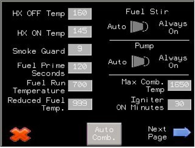

More settings

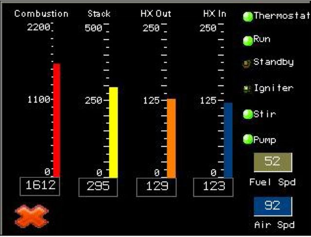

The screen that gets the most use. Shows temps, fuel and air rates, and boiler status.

More settings
