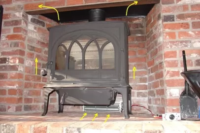

will it do any good to have a blower on my freestanding stove that sits in my fireplace? I'm at work, so this pic of my setup is about all I can do:
I've got maybe 8" clearance around the stove all the way, so I just wasn't sure of two things:
1. the heat behind the stove in this little area being so high that it burns the motor out.
2. not really having much access of air for the thing to actually blow by the stove, unless it does a really good job of taking air from under and in front of the stove and shooting it across the stove top.
If you have a lower block-off plate, yes, it will help throw the heat into the room. Here is what I did:
  • [Hearth.com] blower on my freestanding in fireplace
