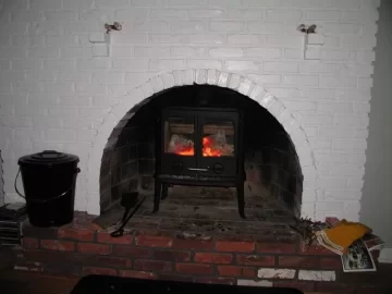

Here is a picture of the stove. We've removed the mantle because it was wood. We are looking at replacing it with a non-combustible material (maybe blue stone). But at least the stove is in and I'm happy to say the stove raised the temperature by at least 10 deg. in the family room. We've got a pellet stove in the living room at the other end of the house and now I'm feeling good with being able to count on these two stoves for the majority of our heating.
What would make this even better is if anyone can help with a suggestion on a blower or fan for this stove. I've found a place that sells replacement fans for pellet/wood stoves. It wouldn't take much to find a sheet metal shop and have them fabricate a case for the fan but I'd rather get something that is already a finished product.
I was hoping for a fan that would sit in the back of the fireplace box and pull air into the box from under the stove and then blow the air up behind the stove. The air would then circulate and come out over and around the stove. I don't have a thermometer yet but a gentle air flow as described should work. Maybe there is a product that really doesn't exist but might have a market..."necessity is the mother of invention". :)
Thanks for any and all suggestions!
Evan

With the stove entirely in the fireplace, I don't think you have to worry about the mantle. You have a full brick heat shield in place.
The fan is a bit trickier. Wish you had a stove with a built in blower system, that would have been easy.
Are you using the top or rear flue outlet on the 2110? In the photo it looks like the top. If you used the rear outlet, the stove would come forward and you would get a LOT more radiation into the room. Plus, the rear outlet gives a more balanced burn on that stove (from experience...). The 2110 is a radiator - it's only jacketed on the rear... so it's dumping alot of its heat into that brick mass.

Trouble is PC is that it looks to me like if they pull the stove forward, they would run into clearance issues with the front of the hearth. I would agree on the radiator part, but the OP's idea of pulling the air through the fireplace would help with that part a great deal. If it were my setup, I'd be inclined to fold a sheet metal "box" that would be open at the back but surround the legs on the front and sides, and mount a couple small "muffin fans" (like are used in computer cooling) on the front so that they'd blow air under the stove then allow it to flow out of the FP around the back, top and sides of the stove. Paint it black and it would look pretty decent, and it wouldn't be all that loud or a pain to listen to, and the juice draw would be minimal.
Yes, but that would be solved by putting something noncombustible on the floor in front of it.
I gamma-corrected the photo and can now clearly see, it is being top vented.
Interesting idea, but I question whether the results would be worth the effort. Getting the 2110 our of that cave is going to do more than anything else, especially if that is an outside wall...
We are venting out the top. We cannot pull the stove out any further because of the hearth. If we vented out the back we would have to build out the hearth for just for the stove to have something to sit on not even considering non-combustible clearances. Right now that is not an option because of the logistics of the family room and how we use it. We have 3 children so the stove needs to be a bit protected. At least we don't have toddlers or younger to have to worry about touching it.
In reality the stove doesn't look that far back in the fire box. It is flush with the brick border of the fire box. You cannot tell in the picture, but there is a brick border that sticks out that frames the semi-circle opening. That is 1/2 a brick out from the face of the fireplace. This is what has made this project so difficult because I would have thought of an insert but it would have been a lot of custom metal work. Add to it that we are greatly limited to the stove dimensions because of space (as well as the our imposed limit on aesthetics - we really like the morso look).
I experimented a bit last night with a fan on a very low setting. I placed it on the hearth blowing in the firebox on one side. It really did make a difference and I believe the theory of pulling air into the fire box will work. The question is how to do it so that it doesn't look bad, is fairly economical, and is not loud (I hate the blower on our pellet stove because it is so loud).
Laslty, I'm going to order the shorter legs. Right now the stove sits a bit high in the firebox. The lower legs will center the stove more as well as provide for even better airflow above the stove.
