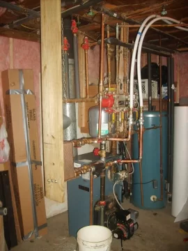

Hmm .. not a real plumber so I am not sure I know what your talking here .. but maybe. I am affraid to admit it here but I put in the oil burner 11 years ago when I built the house .. it's not pretty but does work. No way to bleed at the hishest point (bad design on my part). So in the basment at the boiler .. each zone had a pump .. vales on both sides of that. Above the ball valve is a .. well not sure what it is called ... but it has a fitting for a garden hose and a pepcock to open and drain that one zone .. above that at the elbow before the celler cealing is a little .. well tire valve thing. Wow .. now you really know I am not a plumber! I have purged air from the tire valve thing in the past. I will try and post some bad picts of it.

I see you are using a heat exchanger hooked to the OWB to heat the oil boiler. I didn't know that before, so you can forget about most of the process I suggested earlier. I guess you can try to bleed as you have in the past using the bleeders located above the boiler.(" tire valve thing")
You may also need to hook a hose to the valve above the circulator pump and bleed from there a large quanity of water to force the air thru the system. Make sure you close the ball valve above that same pump to insure that you are pumping water into the oil boiler and thru the baseboard and out thru the hose. Put the end of the hose in a 5 gallon bucket and watch for bubbles. When water flow is constant with NO bubbles, close that zone and move to the next.

Question - After seeing the plate heat exchanger in his picture, is that the way to go when tapping into another system? I also have an oil-fired boiler and I connected in parallel as shown in the EKO manual.
In my limited experience with hydronics Bondo is right splice your lines while air is already trapped in the house piping because you do not want to go through this again,on my system I have to loosen little bleeder caps that are at every radiator yes some time and paitience involved go with automatic bleeders if possible.. The reason that the plate exchanger is being used in his system is because he is running an open system OWB to a pressurized oil boiler,in your case Rich you are pressurized with both boilers no need for an exchanger..Dave
