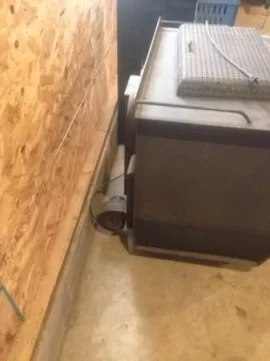

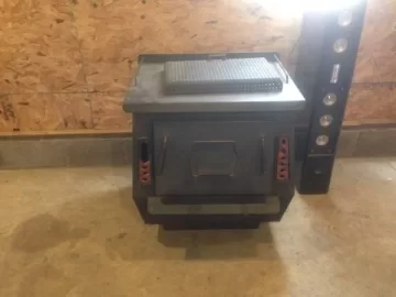

Hello, looking for insight on a blaze king wood burner aprox mid 80's for my first wood burner. Appears to be in good shape and the current owner is looking for $200 for it. It's missing the insert in the middle of the door and one of the side pieces is missing, does have a blower. Other than those minor cosmetic flaws, the stove looks good. Is this worth it or should I wait for a better deal? I am on a limited budget. Thanks!

PTJ202 or 203. Not EPA tested, illegal to sell, purchase or install in some places in the USA.
Value? Caveat Emptor! You can find them in landfills and scrap yards around here.....
Correction, PRJ if it's a rear vent.
