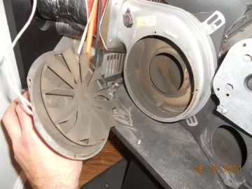

next time you shut the stove down for a cleaning jus remove the piece of steel that those two round cleanouts are in.that whole piece is removable and it will expose the path to the combustion blower.you will see the damper slider also but be carefull not to bump it or you will have to reset the draft again.after you remove the panel just measure the opening that you see going back to the combustion blower.that way you can slide it all the ways open so you can give the path to the blower a good cleaning.then just slide the damper back to its original spot.

Just to be clear you mean this?
[Hearth.com] Black smoke and smell/enviro M55
Found this with doing a search on this site. By the way I love this forum. On here constantly on my iphone. Tons of good members with great info!
