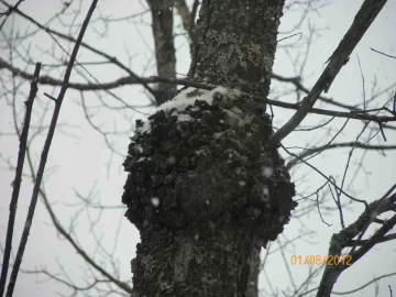

Thistle said:You never know until you cut into a burl whether its hollow & worthless or solid & possibly a treasure.How far up is it? If its not up very high you can remove it with no damage to the tree.Unless you were planning on dropping it anyway.
And how praytell can you remove it with no damage to the tree???Thistle said:You never know until you cut into a burl whether its hollow & worthless or solid & possibly a treasure.How far up is it? If its not up very high you can remove it with no damage to the tree.Unless you were planning on dropping it anyway.

I'm guessing Thistle is thinking the burl is on a limb, not the main trunk. Obviously some damage must occur, but if on a limb, the main tree can be saved. Cheers!
BobUrban said:I have turned bowls from Cherry burls but mostly use them for knife handles I forge. The toughest thing with even the best of burls is getting them dry w/o cracking. It is a long, long process to do it right and consistantly. Custom woodworkers that turn them on a lathe will dip them in parafin wax so that most of it cannot release moisture and it takes years.
