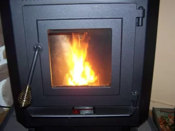

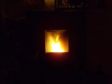

First off I would just like to say that I really like this stove, and it has been keeping my house very warm. The problem I am having though is that after the stove has been running for an hour or so, I'll start to see the upper right hand corner of the glass window start turning black. I have tried three different brands of pellets, but still have the same problem. I also give the stove the stove a good cleaning each day with my shop vac, including behind the baffle plate, scraping the burn pot and basically keeping everything clean. I also have the OAK installed as well. I usually allways have the blower running a couple points ahead as well, like 3-7, or 3-3. Could this be the result of a leaking gasket around the glass or door? I have posted a couple of pics below.

My experience is, I get black or very dark brown all over the glass, except for the upper left hand corner after 12 or so hours of burn. I simply open the stove up slowly when running, take a crumpled up piece of newspaper and wipe the glass. It take 10 seconds or so. I have never had an evident black spot that drew my attention that something may be leaking. Do you have any kind of smoky smell in your house?
Nope, no smokey smell in the house. It just seems kind of odd that it only gets black in the same spot each time. I will say that it does wipe off very easily.
My settings ar 5-5-1 on the bottom three buttons and usually 1-2 or 2-3 on the top two buttons. Hope this helps. Factory settings on bottom three is 6-4-1. With my stove, if you could take that black spot and move it to the upper left hand side, that is the cleanest part on my glass after 12 hours or so and not after an hour.

sooting within an hour is not normal , sooting after a day or two is fairly common, check out your door gasket around the area that its blackening up , you may need to "shift it" a bit or maybe get a replacement from us , no biggie contact the shop and we''ll ship one right out if needed. check also to see that the burn pot is tight and that the "wear plate" the grate your pelets sit on as they burn, seats flat in its resting place. let me know what you turn up and if i need to have you contacted

These stove are basically "air tight"... if you have a bad gasket or leave the ashpan door open they will soot up. They will also soot up if you have a plugged up stove... you may be ready for a "leafblower" cleaning...
