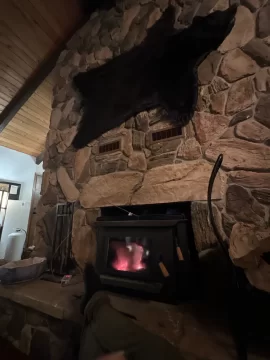

I looked and haven’t seen anything that specifically deals with BKs newish product lines. I don’t have a specific question per se but I would like people’s opinion on BK sending their stoves with steel cats vs the ceramic. I do recall a post from BKVP where he seemed to think ceramic cats are better. Perhaps the technology changed and they are able to get more efficiency out of them? Also, there are a couple options on BKs website that claim 83% efficiency (sirraco 30 I think?) so by that token wouldn’t their King 40 get 83% if you swapped in a steel cat?
Mods sorry if this is a little all over the place, these are just thoughts I haven’t found answers to in the forums.
Pic for inspiration!
