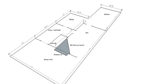

This thing is the real deal; I have been burning 24/7 since Sunday on a pretty steady 12-hour reload cycle. I'm not heating my house 100% as I left the upper floor furnace zone on so my wife and new baby don't get frozen out.
The house is a fairly standard 1970s colonial, with the stove at the center of the main living floor, and 4 bedrooms on the second floor. I've been pleasantly surprised that the main floor is maintaining within 3-4 degrees of the stove room at 72 F. "Some" heat is naturally convecting up the stairwell up to the second floor, but it's hard to say how much. Thermostat upstairs is left at 67 and kicks on periodically but certainly much less often than before the stove.

. I have experimented with turning the fans on for a 12-hour cycle, but mostly I have left them OFF, with the thermostat between 30-40% open. A 400 F stove top temperature seems about right in the current weather (20s-30s). The fans definitely blow air around the stove room, and shorten the burn cycle (by maybe 20%?), but I don't notice them putting more total heat into the house. Of course, I would prefer to leave the fan off, even though they are pretty quiet on LOW, silent is even better.
Do you think the fans increase the efficiency of the insert, of just the heat output rate? In other words, for a given load of wood, do you think the fans increase the amount of heat going into the room (not lost to the masonry fireplace)?
The automagical thermostat damper is so effective that I can hold the stove top temperature anywhere from 400-600 without engaging the fan, so what is the fan doing for me?
