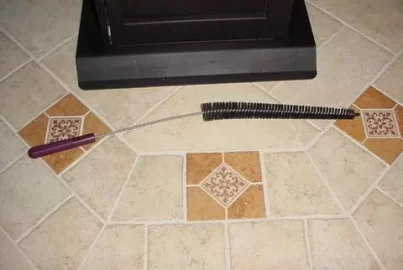

Well I just finished cleaning the beast. Got a little carried away and cleaned everything out, what the hey, it was shut down anyway. Did the exhaust piping all the way out even though I just recently did it. Still pulled out a good amount of ash though. Now, as for the ESP, realizing after looking down the piping that I had to breakdown the unit more than I was in the mood for- still nursing a Superbowl hangover- I realized that if I used a special brush that I have for getting lint out of dryer, I could reach it. The probe had a very good amount of ash built up around it. I ran the brush in gently, the bristles are soft, and kept moving it over and around the probe. That probe turned out nice and shiny. Definitely easier than going in through the back way. Stove started up with no problems, now I'll wait to see if the flames are any better. If I do this right, the attached picture is the brush I used. It is about 28 inches long and tapered. Think I got it at a supermarket. Wife won't be happy to see it laying with the rest of the miscellaneous tools that have gathered near the stove, but I can always get her a new one, eventually.
  • [Hearth.com] Big wild and floppy flames in my Harman P68
