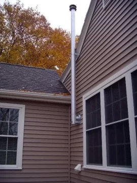

If you have a long run outside you may want to convert to 4" vent on the exterior. I run on 3-4 all the time and my damper is out maybe 3/8 - 1/2" max. I have a 3" exhaust inside and a 4" on the exterior. I also have an outside air kit installed - see pics
  • [Hearth.com] Big E Help
