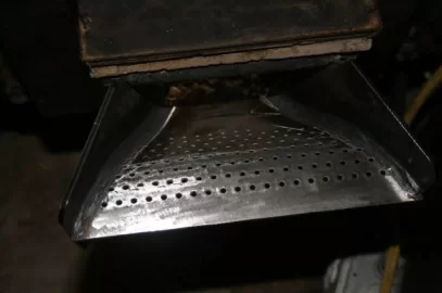

Just finished installing new burn pot on PB 105 with 15 fin igniter. High temp SS on burn surface. We will see if this solves the distorted surface issue! I will be keeping Harman updated as heating season progresses.

Thanks goes out to John at Stovekeepers in Brookline, NH for his help in getting this to happen.
PelletGun said:
Bill B,
Can you let us know whose pellets you are burning? With varied btu content, ash content and most importantly ash fusion temperature values....it would be good to know!
LG, Winter Warmth & Fireside Ultra
