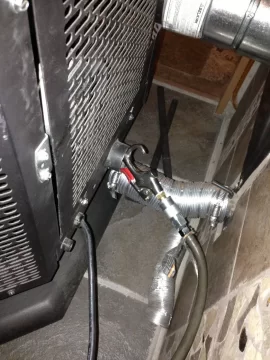

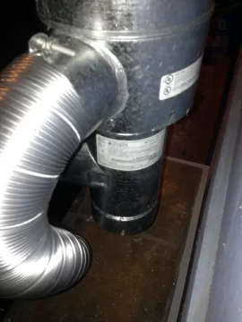

Since we just installed the vacuum cleanouts, I was wondering what might the best way to use it?

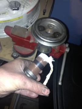

1st I put some TFE paste on the one end of the nipple that I will never take apart.
Then I unscrewed the cap and put the shop vac on the nipple.
My shop vac hose is larger than the pipe. Is there a good way to make it an air tight fit?
After cleaning the ash out of the venting, I put the 150 PSI compressor hose in the air intake of the stove.
Got some more ash. How about putting the compressor in the ash chambers too?
What is the OD of the nipple & the ID of the shop vac hose, Don? Seems to me you can get a small length of correctly sized tubing & run it from the ID of the vac line to the OD of the nipple, OR
sacrifice that particular shop vac hose & securely GLUE a PVC connector to the hose with the identical pipe thread & connect to the BIP with a properly sized union...
Pipe nipple diameter is 1-1/4 inches and shop vac hose is 1-1/2 inches. Thanks I will try something like that.

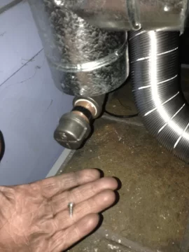

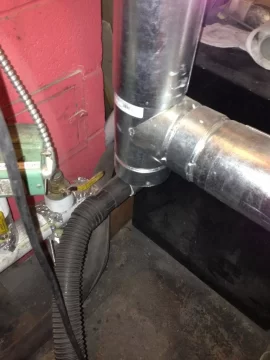

I also had a problem attaching the Vacuum Cleanout to the garage stove.
The vacuum cleanout needs a longer screw and it is very hard to drill a hole in it. So I put it in and used a drill bit instead of self tappers. I made 2 holes one on each side to support the heavier piece. Then screwed it in and it holds very well now and I can still easily remove it.
