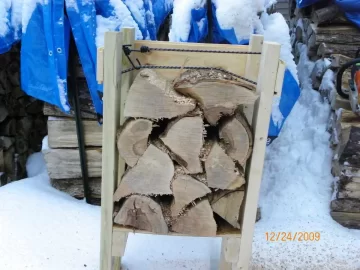

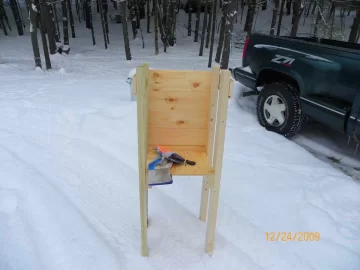

nola mike said:
Just purchased some wood; need 17" max, much of it is 18-22". What would be the easiest way to get 'em to the right length? I wouldn't mind a bunch of 3-4" pieces to help pack the stove. Maybe pack a few in a milk crate or build a box out of 2x4's and nail it to a table or something? Then I could cut a bunch at a time...
This works real good.
zap
  • [Hearth.com] Best way to trim logs?
zapny said:
zap
That's exactly what I had in mind.
Zap's idea is great. That's what I did thanks to his advice on a similar thread I started a few months ago. I had to cut a bunch down to fit NS so I used a modified version of his method.
For some I just wrapped a bungee around a bunch of splits. Placed them on a block and cut them all at once at my desired length. I cut a little over 1/3 a cord in 30 minutes using a method that was very similar to Zap's situation. Hope that helps. Good luck.
