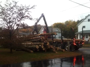

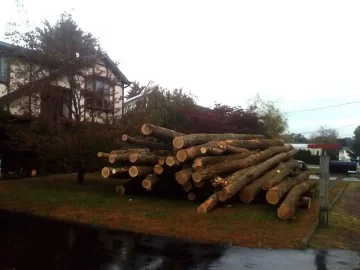

Here are some pics from last year. These logs are about 22 feet long and up to 20 inches in diameter!
I climbed the pile last year. There is NO WAY to pull these by hand.....
What do you all think? I was thinking of winching out a few feet at a time..

How do the neighbors feel about that pile?
I thin you should be OK with the skid method. If the pile is about the same, start with the ones that are near the top, but not on the street side. If you can pull it lengthwise you should be ok. Maybe have the driver leave a couple logs on the ground at the street side to act as a barricade just in case the pile rolls the other way.
Whoa, well I guess I wouldn't be pulling THAT size log by hand either. Pics tell the tale.
I think I'd start on the side opposite the street, low, and work from there. Winching may be your friend in this situation.

Thanks for the pictures.
What we get around here is a huge load of eight foot long poles.
They come stacked the other way on the truck.
Usually there is nothing like a 20" log.
Eight to twelve inches is more like it.
With a pile like that I would drive a couple fence T-Posts in at a 45 degree angle.
They would be on the house side.
I would drive them close together and deep.
Then put a short loop of chain around them to hold a snatch block to thread my winch cable through.
On the driveway side my truck would hold the winch.
Then I would be pulling the high logs off close to the house.
It is nice that they dropped the logs on stringers to keep them off the ground.
Probably the first thing I would do is cut one or more up into short poles to extend those stringers only have a lot more support so as you cut the remaining log stays up off the ground.
As soon as you get the pile down to a decent cutting height forget the winch and start cutting.

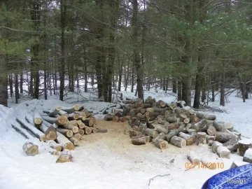

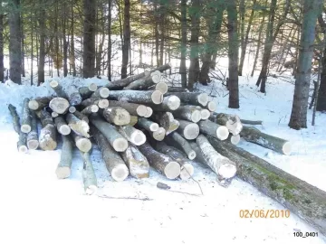

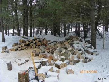

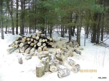

I had a load of log length delivered and when I cut it I worked from the outside in, did that on the front side plus the back side and never had to get on top but my pile was most likely smaller. The third picture is right after he delivered it then the 2nd is after I started cutting from the outside in.
