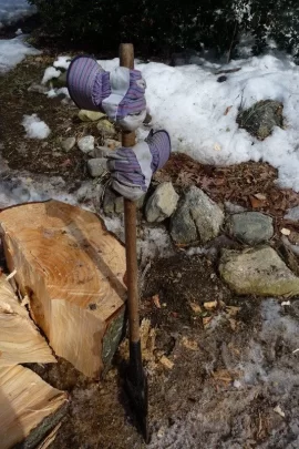

Beware if splitting now:
  • [Hearth.com] Best time to split White Pine
Pine should only be split the first week of a new moon or the second week of a blue moon. You loose too many BTU's if split at other times.

carbon neutral ! LOL that was some sappy wood! I bet those gloves will last a lifetime and waterproof to boot..
Ok, I get the other possibility of the gloves stuck to the axe, and likely the intended one. But with the snow in the picture and location "MA" (Is that Main?) frozen is another possibility to sap for holding the gloves to the handle.
