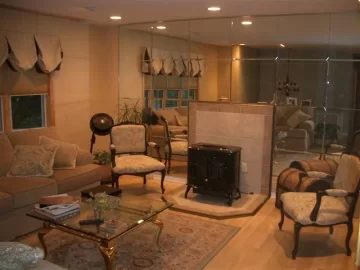

Our pellet insert is installed in a living room fireplace in a 1700 sq ft ranch. The opening to the kitchen is on the other side of the living room, not directly on the wall opposite the fireplace. Once in the kitchen, we have a long hall leading to a bathroom and then 4 bedrooms. We do have a ceiling fan in the living room, oil fired cast iron baseboard heat, and air conditioner vents in the ceiling. My question is what is the most efficient way to bring the heat down the hall to the bedrooms, and to stop it from being trapped in th living room.. We have been running the stove a bit tonight to experiment. Right now, it is 74 in the kitchen, 70 in the farthest bedroom (though it does not feel like that), and probably much hotter in the living room (I estimate mid 80's, though I don't know for sure). Any suggestions would be great! Thanks, Kim

  • [Hearth.com] Best suggestions for bringing heat out of living room and down the hall.
