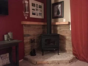

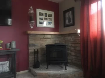

doubt this has anything to do with the post i just want to brag on my work lol adlerlea t-4 almost done. inspections tomorrow morning. what do you guys think?
