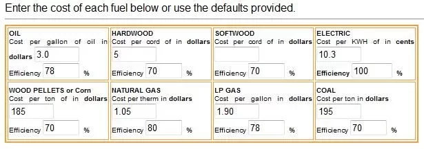

Here is where to find the calculator. OM web doesn't keep a very good site map....
https://www.hearth.com/econtent/index.php/articles/fuel_cost_comparison_calculator/
Here is how the calc looks like for my situation here in Michigan (you have to plug in your values).
**edit*** I guess I should qualify that I get all of my cordwood for the price of about 2 gals of gasoline for the chainsaw and some chain lube and of course, sweat equity.
$27.47 per Million BTU (Oil)of Heat delivered to home
$2,609.65 per year for normal home for Oil
$0.29 per Million BTU of (cordwood) Heat delivered to home
$27.55 per year for normal home for cordwood
$30.18 per Million BTU of Heat delivered to home
$2,867.10 per year for normal home for Electric
$16.39 per Million BTU of Heat delivered to home
$1,557.05 per year for normal home for Pellets
$13.13 per Million BTU of Heat delivered to home
$1,247.35 per year for normal home for Natural Gas
$27.04 per Million BTU of Heat delivered to home
$2,568.80 per year for normal home for LP (Propane) Gas
$10.03 per Million BTU of Heat delivered to home
$952.85 per year for normal home for Coal

KeithO, Thank You for posting the calculator. What I found is not much difference between the cost of pellets/natural gas/ hardwood. What a dilemnia!
